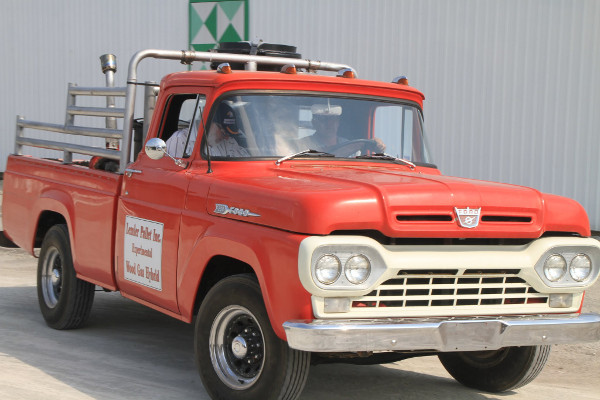

Lemler has a 1960 Ford F250 pickup truck with a complex wood burning contraption bolted down in the back bed.
On this day, Ron poured small pieces of oak into a cylindrical “wood gas generator,” which was located just behind the passenger cab, and actually stood higher than the roof of the cab.
“I used just stuff that we had laying around the shop here; the tank itself was made out of an old water heater and then, so is the filter, and these here were just some old sawdust augers.”
After Ron filled the generator with wood, he used a blow torch to light it through a small opening in the middle of the tank.
“You see the charcoal behind there, that charcoal is red hot already,” Lemler said.
The entire process is a bit like lighting a bar-b-que grill, but in this case, the contraption extracts gas from the burning wood, cools it, and then feeds it to what’s behind the grill of his pickup.

Lemler pushed down a lever mounted to the left of the driver seat that switched the fuel source from gasoline to wood gas. He then turned the key.
Although truck didn’t start on the first try, it wasn’t long before it did, and he was lumbering down the highway.
“It has a little bit of smell,” said Lemler. “Like bar-b-que almost.”

No matter what the season, the truck has to warm up for about five minutes before it is ready to roll.
Furthermore, a wood powered vehicle won’t go as fast as its gasoline counterpart. The top speed of Ron’s pickup is about 65 miles per hour.
On the plus side, if he so chooses, Ron never has to stop at a gas station. “The fuel tank holds about nine buckets (of wood), and it’ll take me between 80 and 100 miles, it varies that much. I think it has to do with, a lot, with headwinds and the type of wood I’m burning and how dry it is, how much moisture content is in the wood.”
