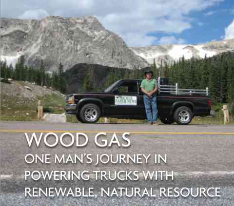

One Man’s Journey In Powering Trucks With Renewable, Natural Resources
With gas prices currently pushing around $4.00 per gallon throughout the country, an Alabama man is utilizing the renewable natural resource NHLA members love so much as a means to get him around. Wood. Wood gas, to be exact.
Throughout the years, Wayne Keith has been a do-it-yourselfer, but in 2004, he took his skills to a new level by modifying his first pickup truck to run on wood chunks.

Nearly all of Keith’s trucks have been Dodge, not out of loyalty, but because they offer larger engines for the size of the truck. Keith prefers the V8 Dodge Dakotas for highway drivers because he said they are sufficiently over-powered. Wood gas conversions lose about 30 percent of the original horsepower, so it helps to have some extra to start with. Most of the lost power could be regained by raising the compression ratio.
Keith said tests performed at Auburn University show his trucks are 37 percent more efficient on wood than on gasoline. They go the same distance on 16 pounds of wood as they do a gallon of gasoline. Keith’s conversions include the following trucks, which have registered more than 250,000 miles:
Wood gas is compatible with any gasoline engine and with some extra work will run a diesel. Keith builds a gasifier unit, including the gasifier, heat exchanger and hay filter. He surrounds it with a rack, which cools the gas and takes it to the motor. Provisions are made to collect condensed moisture and ashes from the gasifier, which only require periodic cleanouts.
The only modifications to the engine compartment are to bring the wood gas up to the motor through pipes, into the air cleaner and regulate the secondary air with an adjustable valve- maintaining the proper fuel/air ratio. Timing is automatically advanced by the vehicle’s computer. The same throttle is used for both wood and gasoline. Keith can switch on the gas instantly, if needed.
To start up, Keith lights the unit and adds wood. Blowers mounted under the truck give draft to the fire and start heating things up. The engine is started on gasoline and quickly switches over to 100 percent wood gas, continuing to stoke the fire with its own suction. Within a mile, Keith is at full power and able to exceed all legal speed limits without using gasoline.
