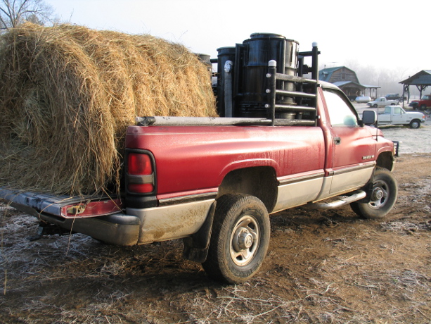

Without giving any of Wayne’s secrets away (and he has several), the technology essentially involves a down draft gasifier. Synthesis gas is then run through cooling and filtering systems and directly on to the carburetor. Depending on engine size, wood consumption is a little above or below one dry pound per mile, and the range is about 80 miles per gasifier-full of wood. Moisture content of wood should preferably be below 20%.

So we got Wayne to drive his biotruck for 40 miles at exactly 55 mph on a 2-mile test track at Auburn University, first on gasoline, then on wood. The result? When driving with gasoline as the fuel, performance was 20.95 mpg, or 168.6 miles per million btu, while for wood it was 231.6 miles per million btu, or equivalent to 28.78 mpg: an improvement of 37%! And tailpipe emission tests show that the biotruck meets the emission standards required by California, which are the most stringent in the nation.
Wayne has now retrofitted several pickups to run on wood, showing an initial preference for Dodge Dakotas, and he has traveled well over 100,000 miles on wood in these vehicles. Each retrofit has resulted in improvements. In September 2011 he officially broke the world wood gas speed record on the Bonneville Salt Flats in Utah, increasing it from 46 mph to 71 mph. Since then he has undertaken yet another retrofit, but this time on a Dodge Ram 2500.
